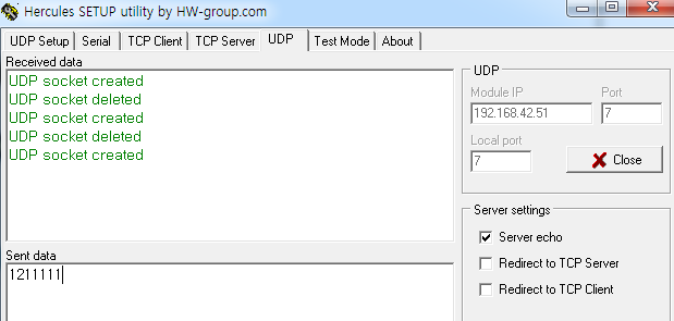

I sent the message using Hercules tool. but Necleo didn't receive massages .

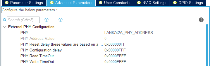

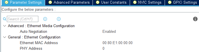

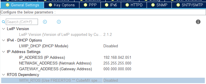

there are CubeMX setting value.
I also change GATEWAY ADDRESS to 192.168.42.1, not working too.
