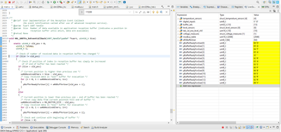

2025-08-22 1:52 AM - edited 2025-08-22 2:08 AM
I just put this example.
My data are well received in aRxBufferUser (it's the DMA's buffer).
The final data that I want to bring back are located in pBufferReadyForReception or pBufferReadyForUser, I'm not sure.
If I take a look in these values, values are moving, because for me, if I look pBufferReadyForUser[0], the data must always be the character 'D', but in live expression, it changes at each time.

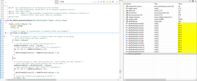

2025-08-22 2:26 AM
I was looking the different values.
1st time : RPI sends a frame, µc receives it. Size = 14 (IT from idle)
2nd time : RPI sends a frame, µc receives it Size = 15 (IT from HT), uwNbReceivedChars = 1, copy of one character in pBufferReadyForUser[0],
then new IT (IT from idle), Size = 28, uwNbReceivedChars = 13, but the copy starts also with pBufferReadyForUser[0], so the first character is deleted.
if (Size != old_pos)
/* Check if position of index in reception buffer has simply be increased
of if end of buffer has been reached */
if (Size > old_pos)
/* Current position is higher than previous one */
uwNbReceivedChars = Size - old_pos;
/* Copy received data in "User" buffer for evacuation */
for (i = 0; i < uwNbReceivedChars; i++)
pBufferReadyForUser[i] = aRXBufferUser[old_pos + i];
else
/* Current position is lower than previous one : end of buffer has been reached */
/* First copy data from current position till end of buffer */
uwNbReceivedChars = RX_BUFFER_SIZE - old_pos;
/* Check and continue with beginning of buffer */
if (Size > 0)
for (i = 0; i < Size; i++)
pBufferReadyForUser[uwNbReceivedChars + i] = aRXBufferUser[i];
uwNbReceivedChars += Size;
