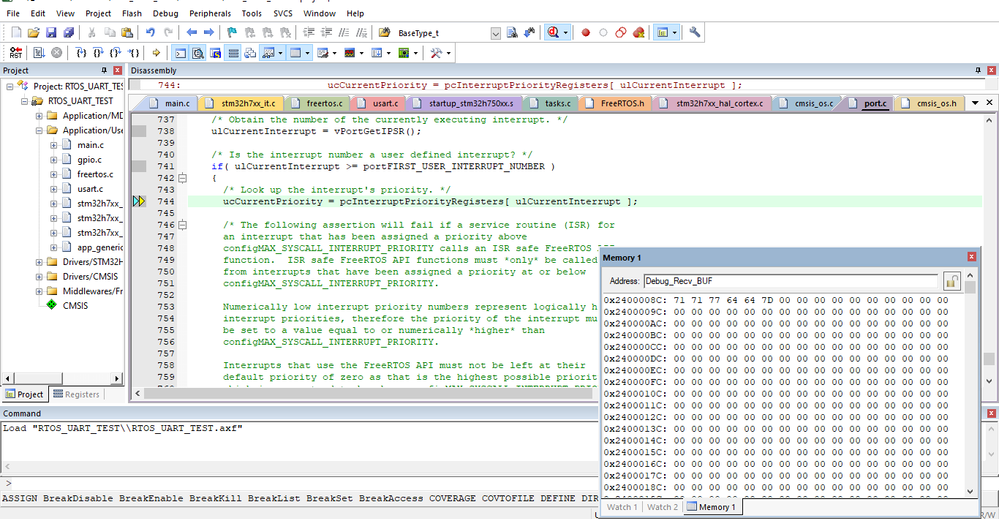

Getting characters from UART and the when I receive end of character i called vTaskNotifyGiveFromISR( Task1Handle, &xHigherPriorityTaskWoken ); function.
then code has not running ,it stopped at
ucCurrentPriority = pcInterruptPriorityRegisters[ ulCurrentInterrupt ]; (see the attached screenshot)
how can I process the data when i received End of character ?
