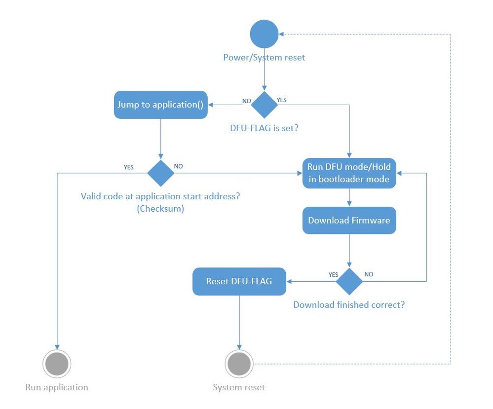

So if this DFU-Flag is not corrupted by application (the value stored in RAM) and a valid code/checksum exists too. I will have the problem if my application do not have any function to set the DFU-Flag, I wont be able to run dfu mode again.
Even if I secure that this function to set the Flag is inside the application it could be broken or someone made a mistake in the program there is no possibility to run dfu mode again.

Back to the bootloader stradegy: I fear most that with this stratedgy I could end up that the bootloader always tries to jump to application.
The effort and safety you put into a bootloader should be justified by requirements of the device, and the update environment. The device I mentioned controls the movement of several metric tons of steel, so it must NEVER EVER get out of control, or people might die. A 'bricked' device is safer than a corrupt device.
Updates in my scenario are under direct human supervision, i.e. there needs to be a cable attached, and a (trained) person doing a sequence of manipulations. An update always happens with already existing application.
And I forgot to implement or I implemented a failing function which doenst that the variable in the RAM correctly. This would mean the bootloader wouldnt be hold the DFU mode.
Only a proper implementation and appropriate tests will help here.Try the 'dumb' scenarios as well, i.e. the user pulls the power or USB plug during erase and during program.

I don't know details about your application, environment, and device access during update.
But the 'DFU flag' could be also be a jumper on a GPIO pin, or something similar.
Yes for sure. Things I haven´t concered, but should be part before every release of a firmware update.
I will keep that in mind if I will update the hardware. But the 'free' GPIO´s are tied to a connector. I could bridge a GPIO to ground by the connector but this isn´t really a solution for me at the moment. As you said I need to have to be sure that these parts of the application runs correctly in the test phase.
