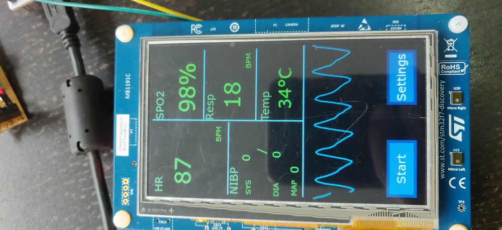

Ok, I solved the issue by going back to the basics, i.e. I break my data into bytes on the transmitting side and then rejoin the bytes on receiving end to get actual data. I used Hal_UART_Transmit_IT to send data bytes. I think sending Bytes is much faster than using Printf as Iam getting real time data by sending Bytes. I am working on a portable pocket size patient monitoring system with all the vital parameters shown along with graph on the display. Currently I used STM32F7 Discovery board , but have my custom PCB ready to get it going. Thanks all for your replies.
image attached
