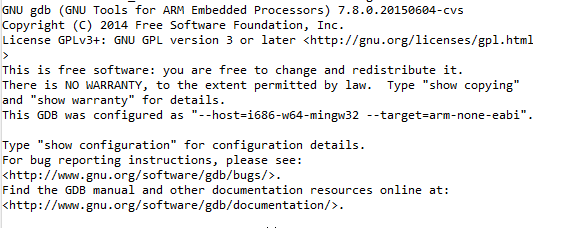

However, when I open a new Command Shell Console in the IDE and type the command "arm-none-eab-gdb --version" i get the following answer:

c:\STM32\Tools\STM32CubeIDE\V1.7.0\STM32CubeIDE\plugins\com.st.stm32cube.ide.mcu.externaltools.gnu-tools-for-stm32.9-2020-q2-update.win32_2.0.0.202105311346\tools\bin>arm-none-eabi-gdb.exe --version
GNU gdb (GNU Tools for STM32 9-2020-q2-update.20201001-1621) 8.3.1.20191211-git
Copyright (C) 2019 Free Software Foundation, Inc.
License GPLv3+: GNU GPL version 3 or later <http://gnu.org/licenses/gpl.html>
This is free software: you are free to change and redistribute it.
There is NO WARRANTY, to the extent permitted by law.So, it does not seem to point to the same version.
I guess some path setup in your system take precedence to the one used by STM32CubeIDE.
Maybe you could check your PATH variable.
