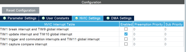

2026-01-30 8:21 AM - edited 2026-01-30 8:43 AM
I looked at your ioc file. You didn't enable Timer interrupt for update event.

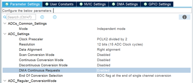

2026-02-02 2:08 PM
It could be possible that you didn't enable DMA Continuous Requests as you didn't mention that you did.
I redid your IOC project to use DMA. I've configured for 2 channels so you can see how it's done with more than 1 channel. I've tested and validated on an STM32F411 which only has ADC1 but all the ADC configurations are the same as the STM32F429. Hopefully i didn't miss copying any of the F411 parameters to your IOC. I did change the Timer3 period so you may need to adjust to what you need.

2026-02-03 12:22 AM
I opened your latest IOC file and i was able to enable the DMA Continuous Requests. Maybe you tried it before you went to DMA Settings and enabled DMA? If so, then you would not be able to enable it.
2026-02-03 5:46 AM
I returned to my home development environment and i was able to enable the DMA Continuous Requests as well. May be itis an issue with my MxCube.Version=6.14.0, at home I use MxCube.Version=6.15.0. With my MxCube.Version=6.14.0 after editing .ioc and generating code my open main.c was frozen !?
