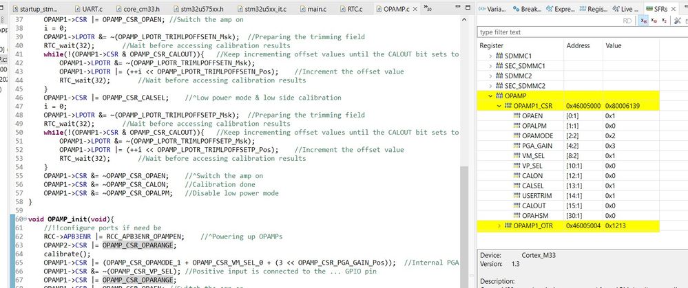

Hello everyone!
I have just noticed that The OPAMP_CSR_OPARANGE bit in NUCLEO-U575ZI-Q is not shown during debug mode. Some bug perhaps?..

Hello @Skfir​,
Thank you for bringing this issue our attention.
I confirm the issue: The 31 bit filed "OPA_RANGE" for the OPAMP1_CSR register is missing in the STM32U5.svd file.
I reported internally.

Hello @Skfir​,
Internal ticket number: 142108 (This is an internal tracking number and is not accessible or usable by customers).
Kaouthar
KDJEM.1
Hello @Skfir ;
The issue is fixed in https://www.st.com/resource/en/svd/stm32u5_svd.zip version 1.3.
