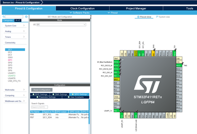

To get my first sensor project done and after selecting my board, I enabled I2C1 which triggered pins PB6 and PB7 as shown below:
