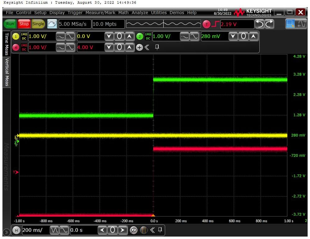

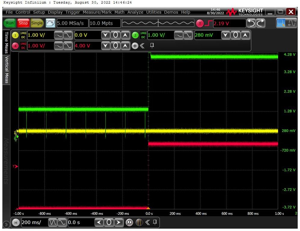

That is not happening in our circuit, and I'm hoping someone can help me understand why or set me straight if my interpretation of expected behavior is wrong. Attached is a scope plot of the operation. Channel 1 is VCC and DB/, connected together and initially pulled low. Channel 2 can be disregarded for now (more details below), it is the microcontroller's PC09 pin that gets pulled up on USB connect. Channel 3 is VDDUSB at the microcontroller; you can see it rises to ~3.3V when USB is plugged in. Channel 4 is CC1c, it also gets pulled up to the dead battery clamp voltage, and then the PC tries to negotiate USBPD (but nothing is listening).
At the center of the plot, we raise VCC and DB/, and note that nothing changes on CC1c. I would expect that since the CC1 pin of the TCPP01-M12 is open circuit, CC1c should be pulled up. We also tried grounding CC1, expecting to see that CC1c gets pulled to ground, but the scope plot looks identical. What am I missing?

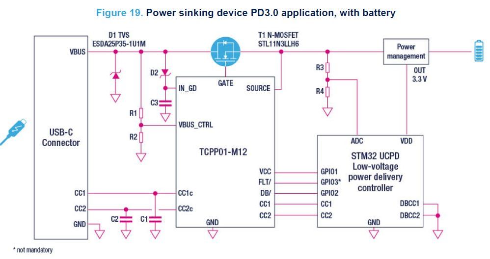

The end result is intended to prototype the attached circuit diagram, which would be the new board assuming this all works. Note that Q? is the FET mentioned in point (9) and the signal USB.DISCONN is the microcontroller's 5V-tolerant PC09.

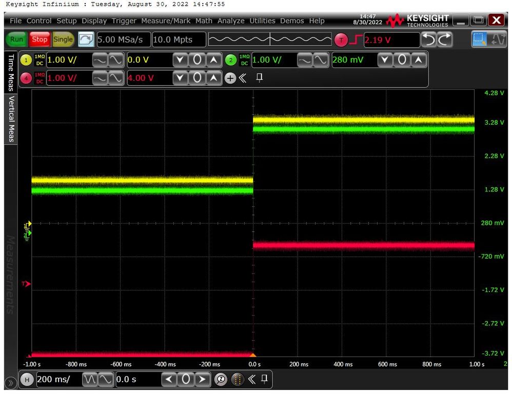

In Yellow and Green: CC1c and CC2c, in red VCC & DB\
I can observe the expected behavior: when VCC & DB\ is high, CC1x and CC2c are pulled up to 3V.
- When VCC & DB\ is driven by a GPIO in push-pull mode
- Or when VCC & DB\ are driven by an external power supply (min 2.4V typical in my bench)
I did the same removing Rp and connecting the board to a SRC1M1 X-NUCLEO
I can observe the expected behavior: when VCC & DB\ is high, CC1x is pulled up to 3V.

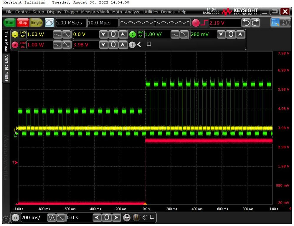

I also tried with a charger and a computer:
We can observe the effect of the TCPP01.
