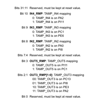

I am working on a project with a STM32H573, using the external tamper lines. CubeMX version 6.14.1.
For configuring certain IN/OUT pins for the TAMP peripheral, RM0481 says that bits in the TAMP_OR register must be set:
However, these bits are not set correctly in the initialisation code. Indeed, it seems that there is no mechanism in any functions in stm32h5xx_hal_rtc_ex.c to set TAMP->OR, and no relevant flags in RTC_ATampInputTypeDef or RTC_ActiveTampersTypeDef.
There is obviously an easy workaround of setting the bits manually at initialisation.
