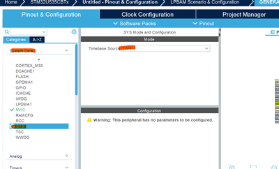

To select TIM6 as the HAL timebase in STM32CubeMX, simply open your project and navigate to the System Core section in the left panel, then click on SYS. In the right panel, you will find the Timebase Source dropdown menu—set this to TIM6. Once selected, CubeMX will automatically configure TIM6 to be used for the HAL timebase functions.
