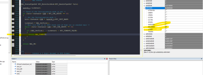

2024-01-23 8:09 AM
Please see attached system viewer, RTCAPBEN is EN
