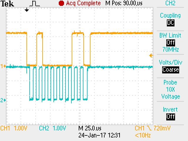

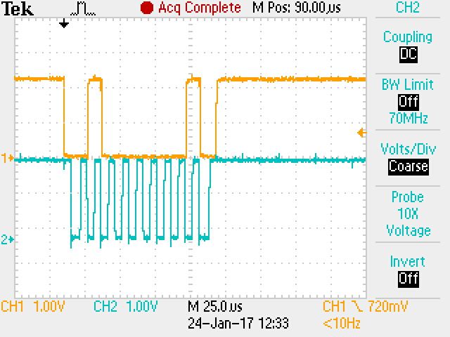

Problem isn't just the read. I can see with oscilloscope, that only the address is sent(1 bytes), even tough I'm sending 50 bytes of data. No extra clocking is generated either. Read only shows the address, but no further clocking is generated.
Scope image of the read:
Scope image from write:

Assuming you're trying to talk to a slave (as you're talking about sending an address)
Your I2C device isn't ACKing the address, which is probably what the error is.
That write transaction you posted is -- in order: start, write bit, 7-bit address 1000001, NACK (1 bit), stop.
Philips / NXP released an I2C application note which explains this; if you haven't read this, it's worth reading.
If a slave doesn't ACK the address by pulling SDA low, the STM32 I2C module will assume there's nothing there and return an error code.
Posted on January 24, 2017 at 14:24
Hot Damn. I misunderstood the NACK as ACK.
There was a problem with the HW wiring. Thanks for the pointer! The ST I2C config is littlebit on the complicated side so I was pretty certain the SW was the culprint :/.
