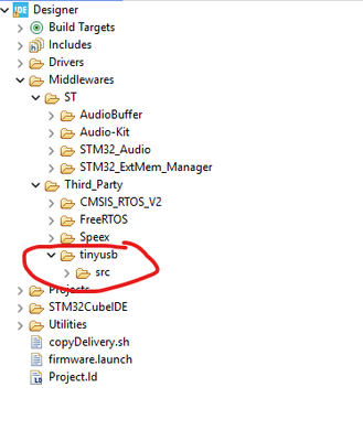

Here is a print screen of latest v1.4.1, tinyUsb is there for STM32N6570-DK and the USB enumerates properly.
What do you mean when you say it is not used?
You open a project and see no code or the USB is not working as expected?
