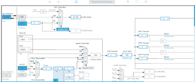

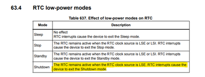

Hello @shivss
Are you using the LSE as RTC clock source ?
According to the reference manual the RTC remain active only when the RTC clock source is LSE.
2025-08-04 1:40 AM
yes am using LSE
