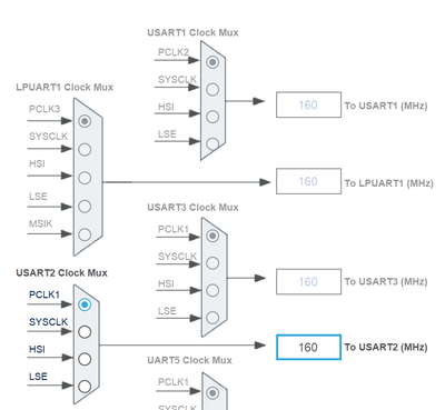

2025-06-17 11:46 AM
Im not expert to Arduino , but waking support require right clock tree setup for USART and work only on USART, that support it.
default clock is PCLK but this in STOP not clock = no wake. Switch before stop USART used to clock , that run in STOP
