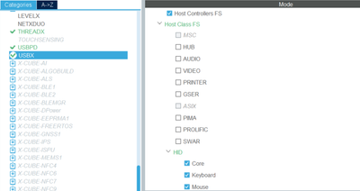

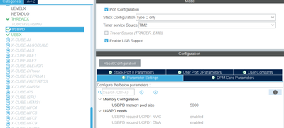

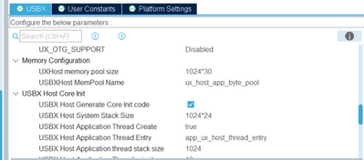

I duplicate all the settings relating to USB host options to mine.
In the middleware:

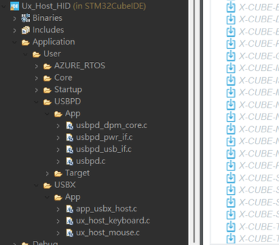

and then copy the source code from the Ux_Host_HID
