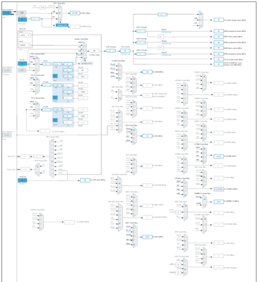

The following is a screenshot of the Clock Configuration screen from CubeMX in case that offers any clues as to what I might be doing wrong

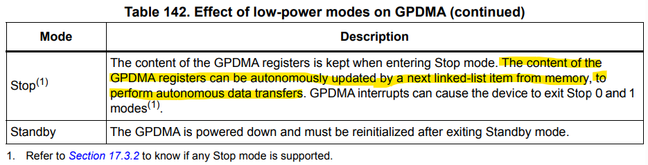

I am able to confirm that the following registers are set to '1' as suggested on page 504 of the RM0456 reference manual:
