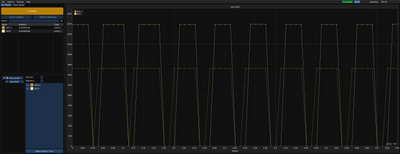

2025-09-12 6:53 AM
I did monitoring of 2 out of 4 channels using MCUmonitor and did notice that the reading periodicaly drop to 0.
Is that something else is trying access the same ports as ADC inputs. How to check it?

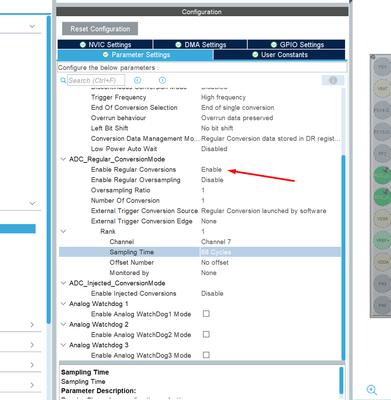

The ADC needs calibrated after startup before it can be used.
You don't seem to be initializing any channel to be sampled. Can you include the IOC?

I am sorry, I was wrong again.
In fact when I did not select the option "Enable Regular convertions" (Cube allows for that) it doesn't generate the Rank for single input.
As result there was no input selected in PCSEL register and so I measured nothing getting the values around 15cnts. When I corrected it I started to get different values like 208cnts. Still doesn't make any sense assuming there is 0,833..V at the input. Then I accidentaly change the input setting from single-ended to differential. I got then value around 5440cnts. By accident it was really close to the value I had at the input so I assumed I solved problem somehow.

2025-09-16 5:32 AM
> For some reason it looks like my ADC is totaly disconnected from the input.
In the picture you posted above, you were getting readings but about 50% of them went to 0. I wouldn't say the ADC looks disconnected. Are you now seeing different behavior?
