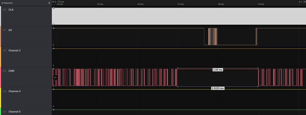

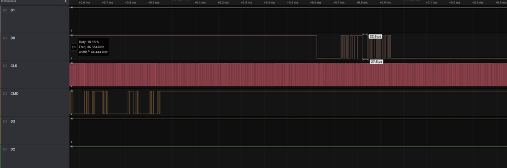

Logic Analyzer shows some communication - card answer:
Initial clock 400 kHz, some request and replay.

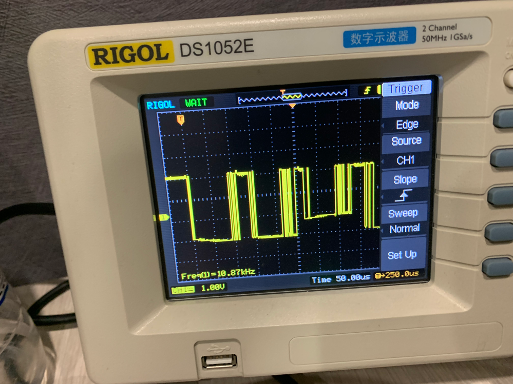

2021-08-17 11:43 PM
Circuit looks like - pull up to logic 3.3V 110k, RC filter 33pF (to GND) 22R (serial). Bus - 1-bit.
When card is removed - no data on D0. When installed - the pic below. Timings looks nice - 1 bit strict 2.5 us.
SD card - some one from nearest store - Mirex micro sd hc 8 GB. iMAC see it.
2021-09-14 1:47 AM
Oscilloscope says - you should soldering better... Problem was in soldering.
Some bytes a going to grey level. After repairing - SD card inited successfully.
