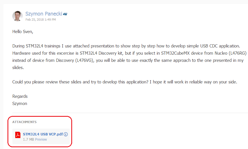

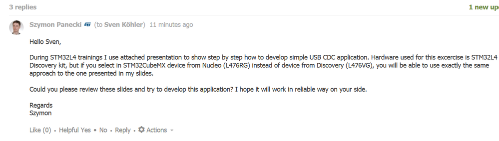

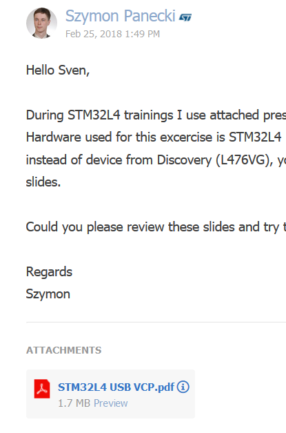

2018-02-25 5:57 AM
You should be able to see it below my message. I can see it on my side like on picture below. Is it visible also for you?
Regards
Szymon
2018-02-25 6:02 AM
Unfortunately not. It is not the first time when you share valuable pdf files but I cannot see them. Initially I was thinking that you send these file using private message.
MAybe I canno use this forum,
What I see:
2018-02-25 6:12 AM
