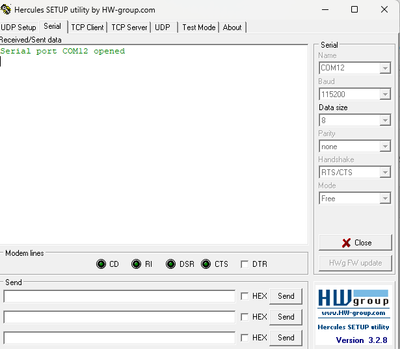

I can successfully receive data from a PC using the Hercules SETUP utility by HW-group.com.

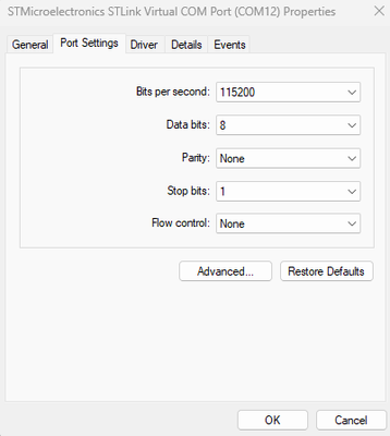

The computer recognizes the card on COM12:
BAUND 115200
Data bits 8
Parity None
Stop bits 1
Flow Control None
The Hercules SETUP utility opens the COM12, but the MCU does not send the object.
char *data ="HELLO LUMUS!\n" to the USB buffer.
