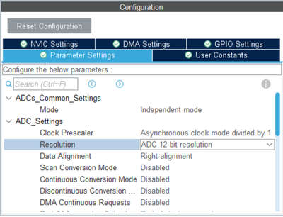

Yes, you can configure the resolution from 12 to 10, 8 or 6 bits. Using CubeMX, under ADC Configuration -> Parameter Settings (ADC_Settings) you can set the Resolution you want:
