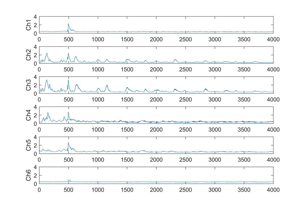

This figure shows the 6-channel results. The results from ch1 and ch6 are wrong. I compared with an oscilloscope. Do not know the reason.
Ch 1 was correct in the 4-channel test.
I checked my code and results again. I found ch2 - ch4 are great,
but the data from Ch 1 were overwritten by the data from Ch 6.
