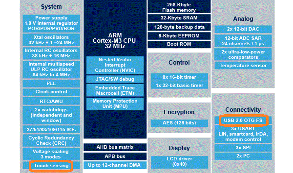

Has anyone used the STM32L series USB in host mode?
I'm looking at this part at design-in stage. I need the Capsense feature but I also need to use USB in host mode to support optional WiFi.. The ''circuit diagram'' on the website says it has USB OTG FS but I can see no reference in the specs. Thanks #w5500 #usb-host #usb-stm32l2014-03-10 6:43 AM

As far as I'm aware the STM32L15x series didn't support USB FS OTG
What about thehttp://www.st.com/web/en/catalog/mmc/FM141/SC1169/SS1295/LN1808/PF255680
? The diagram does say OTG, but the docs/sw don't seem to support it. Will push to moderation.2014-03-11 5:23 AM
Hi Clive1,
I confirm; STM32L1 doesn't support USB OTG FS. This includes STM32L100. Thanks for your relevant feedbacks Clive1, issue with web diagrams will be fixed soon. -Mayla-To give better visibility on the answered topics, please click on Accept as Solution on the reply which solved your issue or answered your question.

Thanks All, I suspected as much. Copy and Paste error!
