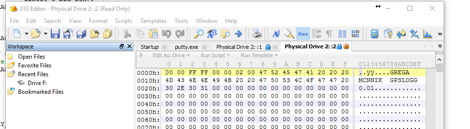

I ran an example, which was generated in STM32Cube. I connected the USB with the PA11 and PA12. I set the jumper on E5V and the device showed on my PC (Raw file system). I can see the memory map with HEX Editor.
> I wish to access my data on the flash. How can I do it? You may directly read the drive sectors from the MSC device to your PC, like your 010 editor / drive editor mode. For Linux application, just open() the drive device, like this post,
