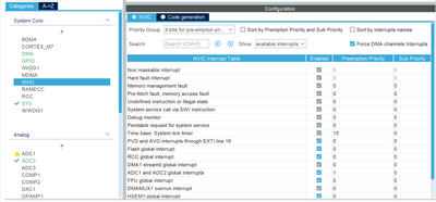

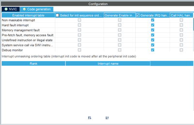

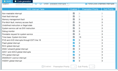

When I'm trying to use DMA for ADC data collection I'm experiencing MCU crush. Currently I know that issue happens when DMA fill half of defined buffer.
I'm using STM32CubeIDE and builded in CubeMX. To precize issue I used debug By SWD STLink. to be able run code step by step I desabled continuous conversion mode. Attaching my Cube MX ADC settings:
And DMA settings
