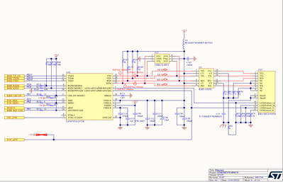

I am using the STM32H747IIT6 microcontroller along with the LAN8742A Ethernet PHY, configured in RMII mode. However, I am facing issues where the Ethernet interface is not working at all in my circuit. It appears there may be multiple bugs or configuration issues affecting the RMII driver.
I suspect there are underlying bugs in the RMII driver implementation. I would appreciate any advice or suggestions on how to resolve these issues and get the Ethernet interface up and running as soon as possible.

I have STM32H7I-DISCO board. LAN8742A schematic fully same with development board. This is not my first PCB design, I don't think so this is hardware issue. I'm looking for a detailed, step-by-step guide that outlines the key points to consider during project configuration. I've noticed that many users, including myself, are experiencing difficulties running the Ethernet LwIP stack on the STM32H7 series.
