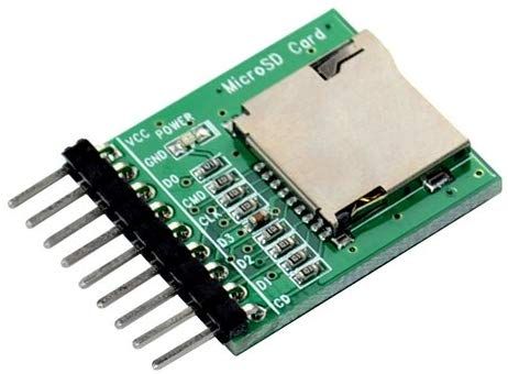

I am using sdmmc in 1bit mode for now (the module I have only supports 1bit mode):
I installed 10k pull-up resistors on DI and D0.
when I use f_mount() it returns FR_NOT_READY. the card detect pin is plugged and configured in FATFS in cubeMX.

}I am now on a 4bit mode SD reader, I changed to 4Bits in cubeMX.
my reader has nothing but the sd slot, no resistors, no voltage translator on the board. I added 10k pull-up resistors on dat0,1,2,3 and cmd, everything connected on a breadboard
