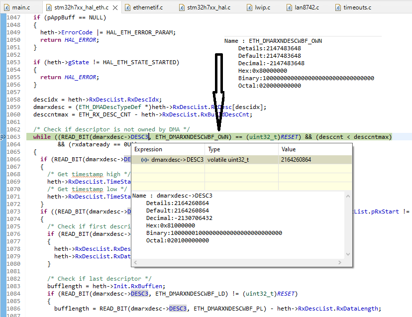

The program does not pass /* Check if descriptor is not owned by DMA */ check (HAL_ETH_Read Data in the file stm32h7xx_hal_et.c line 1063) due to the values of the descriptors heth->RxDescList.RxDesc. It is equal to 0x81000000. In another, working project, it is equal to 0x3401003С.
Most likely, I did not fully initialize correctly, because the same project worked on NUCLEO-H745ZI-Q before the changes. I don't fully understand how packets are received via DMA. But what should I change except LAN8742_Init function?

I don't have STM32H745 but 0x81000000 does not look like a valid internal RAM address.
0x340100xx is a valid address.

RDES3 is not a memory address, but just a configuration word. 0x81000000 is an OWN and BUF1V bits, which seems to be OK.
