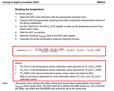

IT IS POSSIBLE TO KNOW HOW TO CALCULATE MCU INTERNAL TEMPERATURE OF STM32H743ZITX SERIES IF YES THAN HOW I DO IT GIVE ME CODE AND PROCESS ....

From the reference manual:
See also these threads to inspire from:
https://community.st.com/t5/stm32-mcus-products/stm32h7-on-chip-temperature-sensor-reading-stable-on-y-revision/td-p/300107
https://community.st.com/t5/stm32-mcus-products/internal-temperature-stm32h7-delivers-wrong-value/td-p/612538
