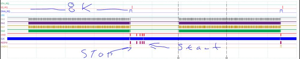

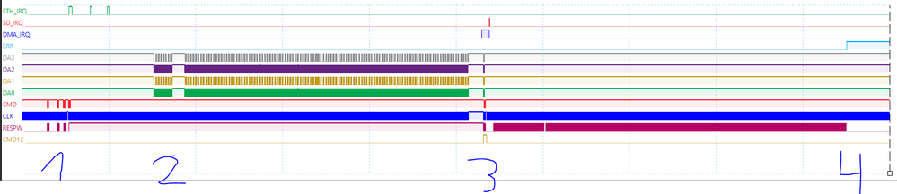

I did some investigation on that issue and tracked the problem down to SDMMC_GetCmdResp1. Here the code is running into a timeout. I did some hard debugging to figure out to get more info about it. I think I found the following:

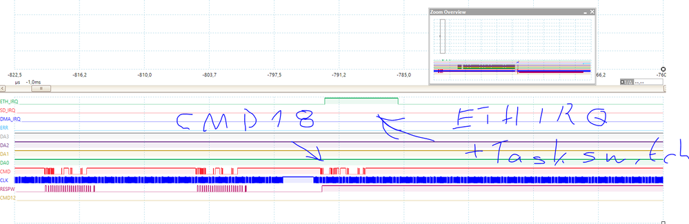

1.) After the ending of previous 8k read the next read multiple block command (CMD18) is sent to the card and wait for the response. Below picture show the zoom of the start.
While handling the CMD18 response an IRQ of the Ethernet is occurring. The toggling of RESPW stops although the response is not even received (in above zoom it is setting RESPW to high). Reason for that is that the Ethernet IRQ is serviced (is fine). However, with the IRQ the scheduler also seems do a task switch. The task for the SD card seems to get suspended.
2.) The data transfer starts and DMA is handling this. SD card task still seems to be suspended.
3.) The data transfer is complete, DMA IRQ handles the stop command and overwrites by that the contents of the SDMMC_STA register. Short time after the SD_IRQ is handled the SD card task is getting back context and continues. However, as SDMMC_STA was modified by the DMA IRQ the SD card task never sees the result of sending the command.
4.) SDMMC_GetCmdResp1 runs into timeout
I haven't tried the patch by now but I thought it should be in the STM32F7 firmware package.
