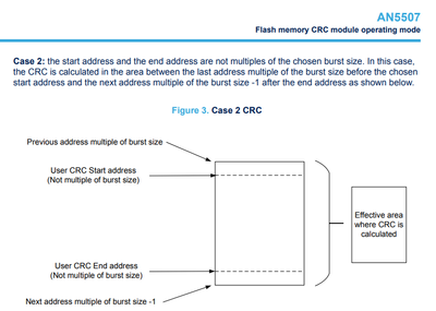

I'm trying to use the flash crc but is not working as expected. If I pass the end address with offset 3 or 7 the result of crc calc will be always the same, 0xba4bbbf0. What the problem here?

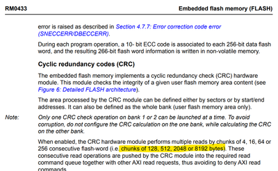

The data must be aligned to chunks of the 4x flash word size (or whatever you have selected as the burst size). In this case, it must be aligned to 128-bytes. The minimum size is therefore 128 bytes.

That's correct, this document said the same
