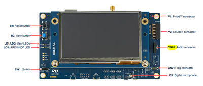

2024-07-16 3:07 AM
Hello @NRedd.2 ,
To ensure proper functionality, you must plug the MB1299_Microphone_MEMS_Module into the STM32H735G-DK ( on CN20). We have tested the example using this MEMS module, and it works correctly.
STM32H735DK board :
STM32H735dk
Microphone MEMS Module :

2024-07-16 4:56 AM
Hello @MOBEJ ,
Thank you for the quick response!
I assumed that the example provided (DFSDM_AudioRecord) was for U33 MEMS mic which is onboard on the top side.
Is it not the case?
If so, do you have an example for the onboard MEMS?
