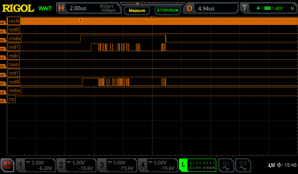

I am using STM32H735 with RTOS LwIP with a DP83826 PHY, and want to see at least a ping on the network.

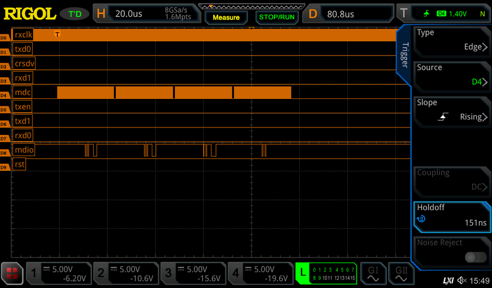

From HW point of view the PHY seems to work because I can communicate with it and read config registers. The strap pins are set to a valid default configuration.
On the Rx0+Rx1 pins at the uC I can see some incoming frames (oscilloscope), but there are no output Tx0/Tx1 frames visible.

Hello, yes reading / writing PHY registers works fine
DP83826_BMCR: 00003000
DP83826_BMSR: 0000786d
DP83826_PHYIDR1: 00002000
DP83826_PHYIDR2: 0000a111
DP83826_PHYSTS: 00004f11
DP83826_PHYSCR: 0000010b
DP83826_PHYCR: 00008401
The PHY Address is in PHYCR Bit0-4 and is 1, I hope also that I do not have configured something wrong, but the strap pins are setup for basic-mode including RMII interface. rxclk = 50MHz, Bias resistor is correct. 100Mbit is set... all according data sheet. I will investigate in the deadlock that you wrote below, thank you!
