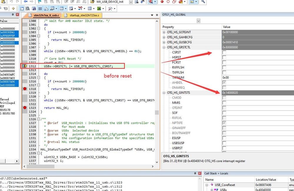

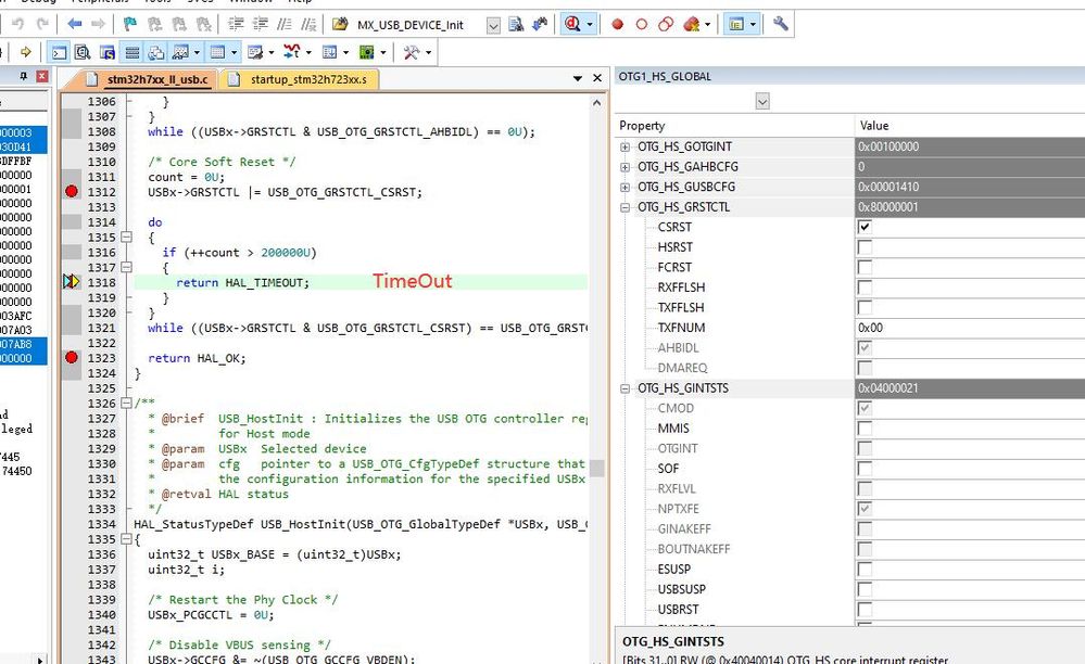

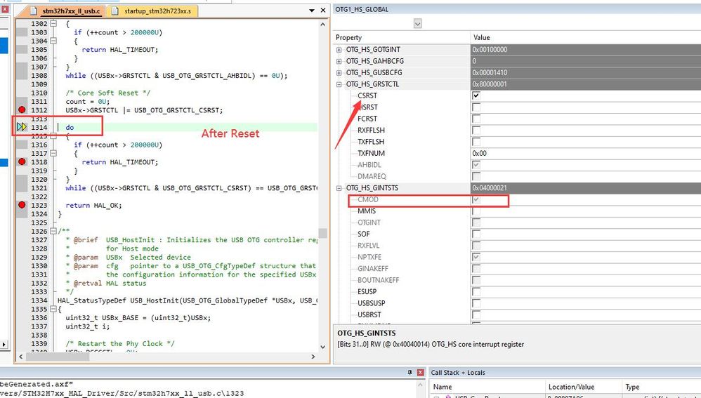

when i debugging:
pic1:
0693W00000BcDRkQAN.jpg​pic2:
0693W00000BcDWAQA3.jpgpic3:
 0693W00000BcDWKQA3.jpgdatasheet:

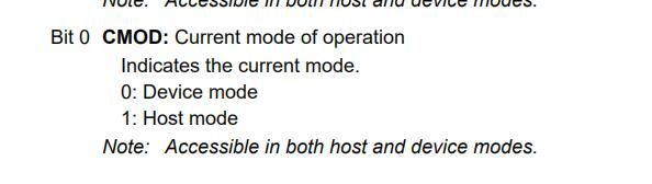

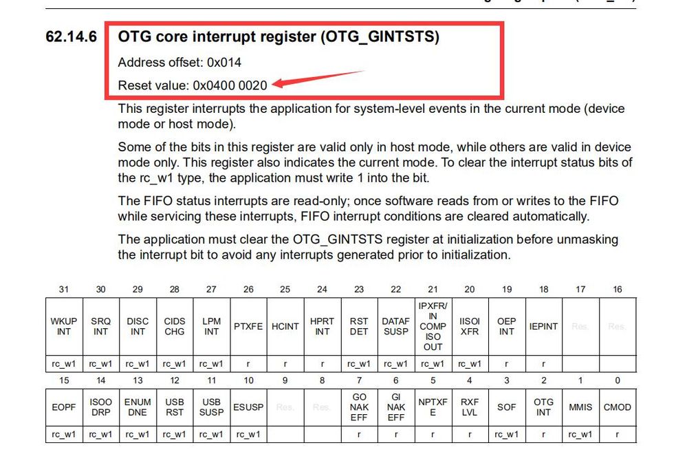

0693W00000BcDXDQA3.jpg0693W00000BcDXcQAN.jpgAccording to the data sheet, after the reset operation, CMOD should be 0, but it is actually 1. Why?
The code generated by CUBEMX cannot be used
I use the USB3300 chip for the interface.

Hello @guo qiang​ ,
Try to update the declaration of the count parameter as follows:
__IO uint32_t count instead of uint32_t count
Please let me know if this solves your problem.
