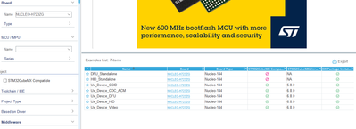

I was trying to use the usb cdc acm example from STM32CubeMx for a Nucleo-H723ZG board. When i run the example, the device doesn't get detected at by my computer.

Nucleo-H723ZG examples do not include CDC.
Probably you're using some other source, and we don't know which.
2024-09-03 7:23 AM
I was using the stm32cubemx and the cdc example is there
