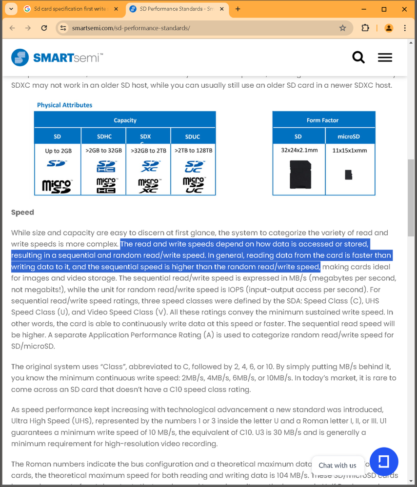

2024-06-06 4:38 PM
I found this: a random read/write is slower as a sequential read/write.
It means in your case:
the first write is random (it is a different sector, after all the File System FAT reads done). But writing a file will be done in a quite consecutive (sequential) way: usually, files on media are managed by a File System using clusters: a cluster is larger as a sector (e.g. 4K or even larger if entire media is large) and consists of N consecutive sectors. And writing more as one cluster (N sectors) will potentially find also a consecutive (free) cluster (and therefore consecutive sectors). See also "fragmentation" of drives which slows down when all clusters are spread randomly, for best speed: all clusters (sectors) as a sequence on media (and access in a sequence).
So, the first write is a random write, all the following writes (within the same cluster) are consecutive. This could also explain why the first write is "slower" as the following writes.
And as I understand: the specs. of SD cards provide often just the speed for consecutive writes. So, a random write is not specified (figure not provided), but assume it is for sure slower.
So, I think: it is the SD card (and how it works - why the first write is slower as all other writes (potentially all following writes are consecutive)).

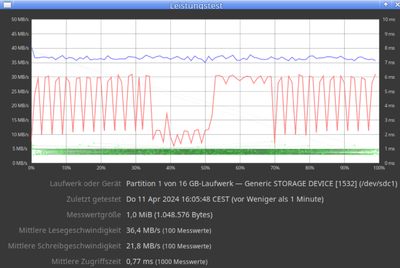

2024-06-06 11:12 PM
And see the speed test of an "good" sd-card : writing 1MB blocks, in red; read is good, blue;
and access time 0,7ms, but one is 10x slower (green dots).
So afair the medium is called "ok", if there is no access time > 300ms !
From my tests, i can say: even from same type of card, same supplier, you can get one card with "perfect" timing, the next looks like the pic.
Did you try some media from other manufacturer and supplier ?
