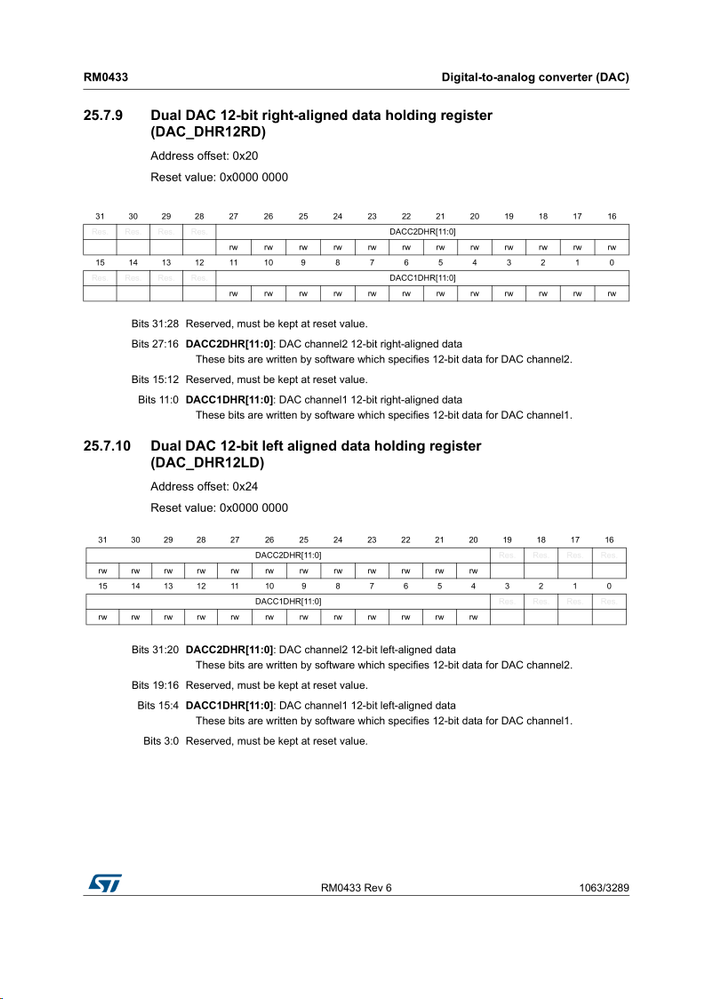

2020-11-14 4:09 AM
You simply use the dual registers as target in DMA.
2020-11-14 4:19 AM
That was the missing part of the puzzle. Somehow managed to miss that register!
