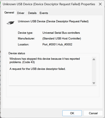

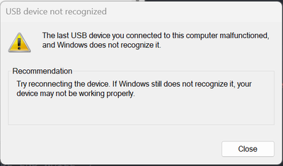

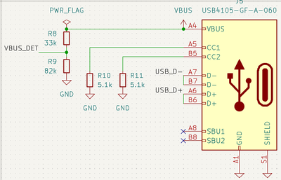

Thanks for pointing me to that example - I don't know how I didn't find that earlier! I have adapted that example to my board; it seems that the USB device initializes, but unfortunately, my computer says that it does not recognize the device.
Looking at other solutions to this problem, I have added
HAL_PWREx_EnableUSBVoltageDetector();
if (HAL_GPIO_ReadPin(VBUS_SENS_GPIO_Port, VBUS_SENS_Pin)) {
    HAL_PWREx_EnableVddUSB();
    usb_connected = true;
 To my initialization code, but it seems to have no effect. I'm pretty sure I have the USB lines wired properly, but I could be wrong.
Hi @nifley
Do you reproduce the issue using reference board for example NUCLEO-H533RE?
