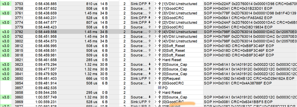

Used UCPD module to transfer UVDM packets. After some time, the UCPD module is not transmitting and receiving the data. For reception we have enabled RXMSGENDIE , RXNEIE and RXHRSTDETIE interrupts. for transmission ,we have enabled TXISIE , TXMSGSENTIE and TXMSGDISCIE interrupts.The UCPD module recovers after multiple hard reset. Used Non Blocking prints in the UCPD interrupts we didn't see any TX/ RX during this issue. We are not using DMA for this process.
