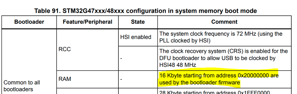

I'm trying bootloader of nucleo STM32G474RE and faced several issues :
With 1 and 2, I think this is a typo of the manual.
Please kindly advise. Thanks in advance.
2020-10-01 7:28 AM
The bootloader needs some RAM to work with. Writing over that at 0x20000000 isn't going to work well. AN2606 should have details on how much RAM is used.
