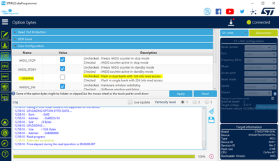

To switch from dual-bank to single-bank mode , we recommend using STM32CubeProgrammer to modify the flash option bytes by :
1- Connect your device to your PC and open STM32CubeProgrammer.
2- Navigate to the Option Bytes tab on the left sidebar (highlighted as "OB" in the image).
3- Under User Configuration, locate the option named nDBANK.
4- You will see that:
When unchecked, the device operates in dual bank mode with 128-bit read access.
When checked, the device operates in single bank mode with 256-bit read access.
5- To disable dual bank mode, check the nDBANK box to enable single bank mode.
6- Click Apply to program the option bytes.

I would still like a little more clarification on this. I have been using CubeIDE on its own quite happily, and I have only just downloaded CubeProgrammer as a result of this answer. How do the two work together?
I'm concerned that the nDBANK setting is only set temporarily from CubeProgrammer, and does not seem controllable from CubeIDE, so how would I ensure that the nDBANK setting I require is preserved across reboots/power downs?
