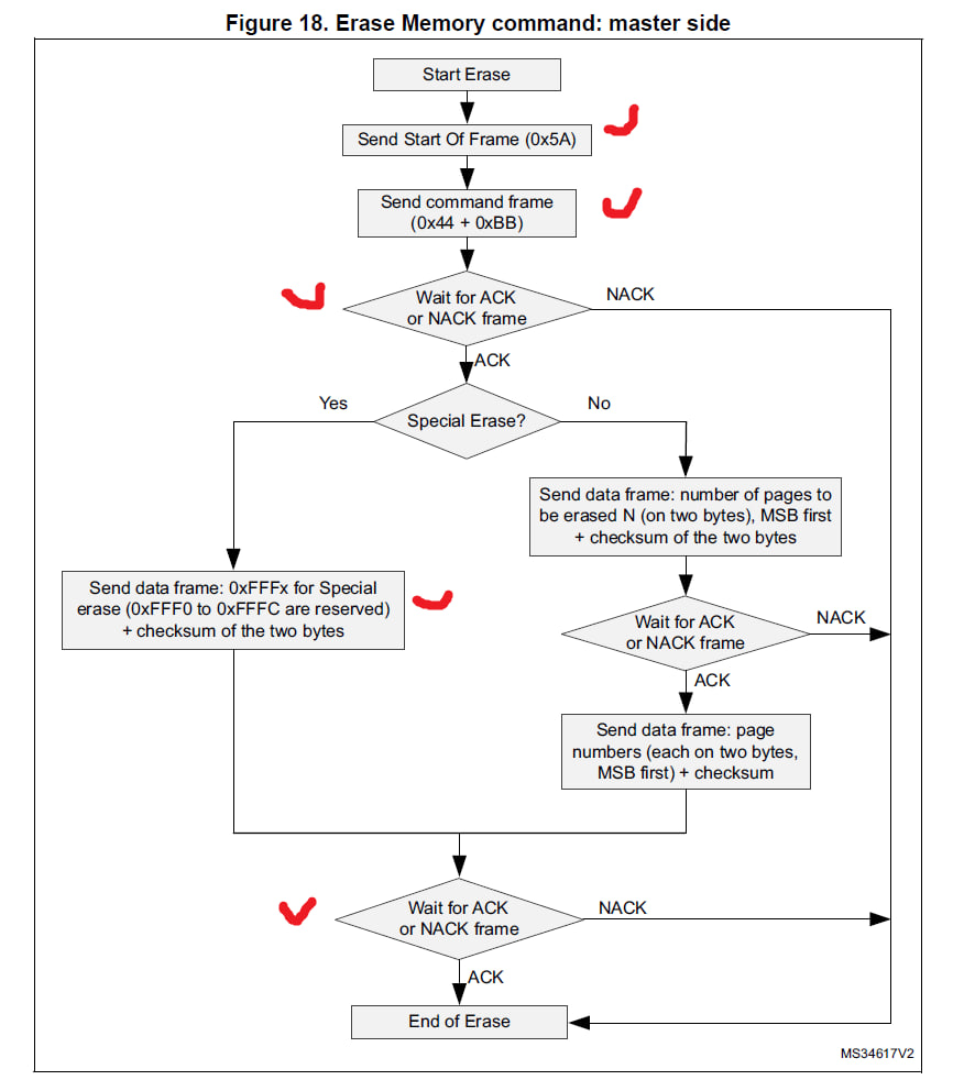

2) Here is where it gets weird. I've implemented EraseMemory as mass erase (Figure 18, left-side flow), by sending 0xff 0xff 0x00 and then waiting for ack.
0693W00000YAm5PQAT.pnghere's the traffic flow over SPI:
SPI 5a->a5 < frame
SPI 44->a5 < cmd + crc
SPI bb->a5 < cmd + crc
SPI 00->a5 ... SPI 00->a5 < wait for ack
SPI 00->79 < ack
SPI 79->a5 < confirm ack
SPI ff->a5 < data frame for mass erase
SPI 00->a5 < data frame for mass erase (crc)
SPI 00->79 < ack
the SPI 00->a5 ... SPI 00->a5 bits are repeated transfers of 0x00 -> reads of 0xa5 until ack is finally returned.

The flowchart on AN4286 Figure 18, "Wait for ACK or NACK frame".
My "wait for ack" code is exactly like this (AN4286 Figure 2)
