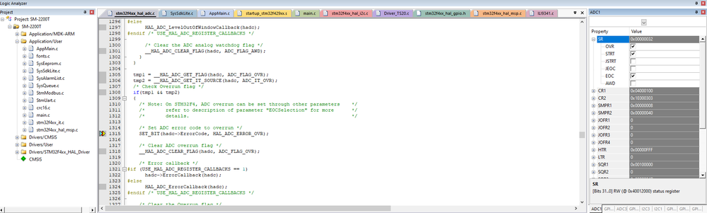

I am testing ADC and DMA functions on my custom board.
every conversion set ADC->SR OVR bit.

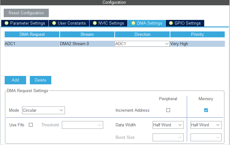

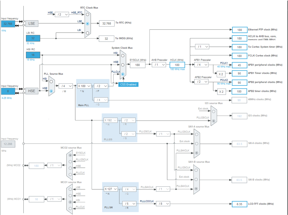

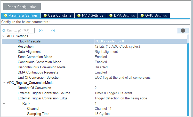

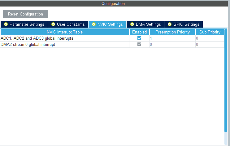

HJung.6
Associate II
add mxcube setting.
