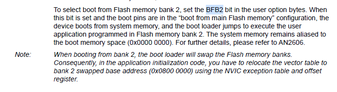

If memory serves me well, I ended up implementing without bootloader or runtime code swapping. I would receive new FW binary, check the current bank, write it to the other bank. Then toggle dual-bank bit in flash option bytes and reboot. Internal system bootloader then aliases either 0x0800000 (bank1) or 0x0810000 (bank2) to 0x00000000 (depending on dual bank enable bit) and continues from there. This allows for 2 things - no need to recompile for specific banks and system would also boot into previous bank, if new firmware gets corrupted (system bootloader checks for at least vector table in the bank before booting).

I didn't want to use the BFB bit as started to get messy in my earlier testing, the manual was somewhat vague about it all and looks like you still need to remap the vector table anyway...
