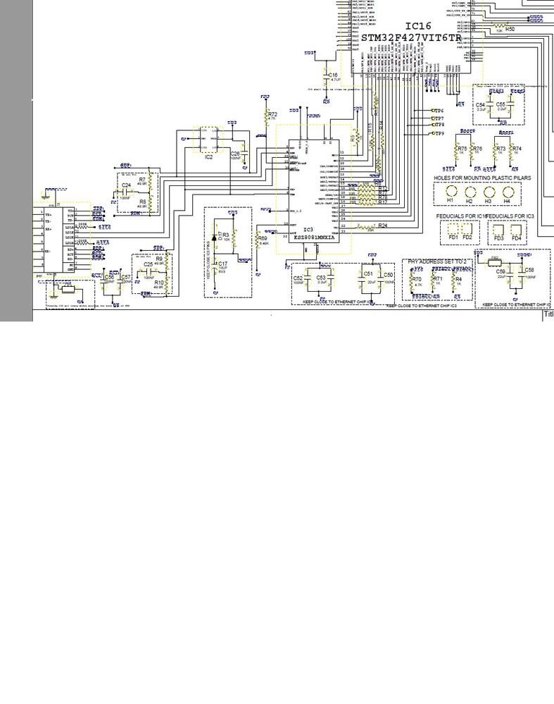

I am using STM32F427 controller. I am using KSZ8081 Ethernet PHY Transceiver.
I have configured the controller for MII interface.
I have set the IP address and trying to ping the board from PC. There is no response.
How to check the controller configuration is working properly?
How to check the Ethernet chip is powered up?
Please let me know how to check this from hardware and software perspective

2021-08-24 11:41 PM
Hardware : I have attached the schematics of how the microcontroller is interfaced with the Ethernet PHY chip. Please go through and let me know for clarifications if any.

2021-08-25 1:04 AM
Could you please provide the initialization code?
2021-08-25 4:30 AM
Hi
1 Write_PHY_Reg( Phy_port, 0x1F, (RMII_CLK_SEL|HP_MDIX_SEL) );
2 RegValue = ( PHY_KSZ8081_REG_INTRPT_JABBER |
PHY_KSZ8081_REG_INTRPT_RXERR |
PHY_KSZ8081_REG_INTRPT_PGERR |
PHY_KSZ8081_REG_INTRPT_PRLFAULT |
PHY_KSZ8081_REG_INTRPT_LPACK |
PHY_KSZ8081_REG_INTRPT_LINKDOWN |
PHY_KSZ8081_REG_INTRPT_REM_FAULT |
PHY_KSZ8081_REG_INTRPT_LINKUP )
Write_PHY_Reg( Phy_port, 0x1B, &RegValue );
3 Write_PHY_Reg( Phy_port, 0x00, 0x1000 );
4 Read_PHY_Reg( Phy_port, reg_addr, &basic_status_value );
When reading the basic_status_value, it is 0x7849. The link is not established.
