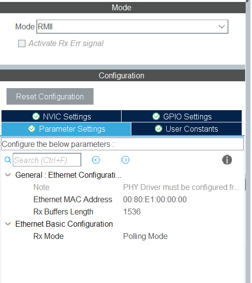

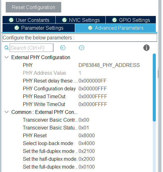

YPark.13
Associate II
_legacyfs_online_stmicro_images_0693W00000bjlaYQAQ.png As shown in the picture, the IOC setting part has two different chip settings STM32F407ZET (5 pieces)

waclawek.jan
Super User
I don't use CubeMX but to me that looks like in one case you are configuring a ready-made board with an on-board PHY, and in the second case a bare chip.
