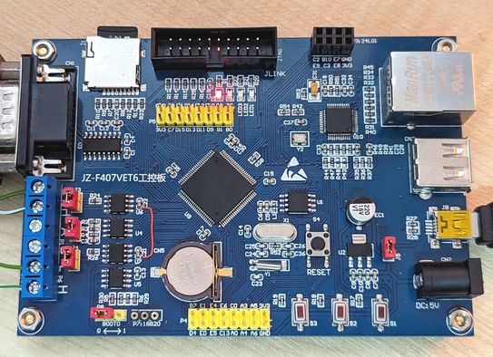

I have the following Board with an STM32F407VET:
I started from a github repo with a working configuration:
https://github.com/art103/JZ-F407VET6
I removed everything I don't need in my .ioc file, created the code and added the following files to the while()-loop in the main function:
HAL_GPIO_TogglePin(GPIOE, LED1_Pin);
HAL_Delay(500);
HAL_GPIO_TogglePin(GPIOE, LED2_Pin);
HAL_Delay(500);
HAL_GPIO_TogglePin(GPIOE, LED3_Pin);
HAL_Delay(500);
and I can see that the LEDs are changing, so I expect the basic setup is correct.

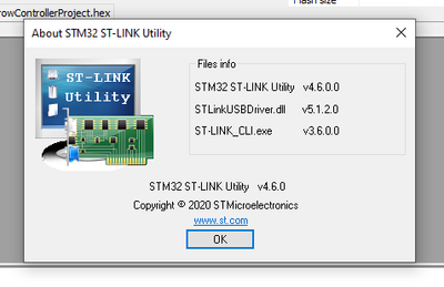

PS: ST-Link Utility is a deprecated tool and no more supported. Use STM32CubeProgrammer instead.

Thanks a lot for your help. I have another board, I'll try it.
So if the other board is also not working with freertos is there something else I can do?
For me it's super wired that everything is only working without RTOS.
Is there another dev board with ethernet available which is freeRTOS tested?
Thanks for your help
Update: other board is also not working
Update2: I tried to flash the program without freeRTOS with STM32CubeProgrammer => working, but as soon as I enable freeRTOS the issue is back - nothing happens :(
